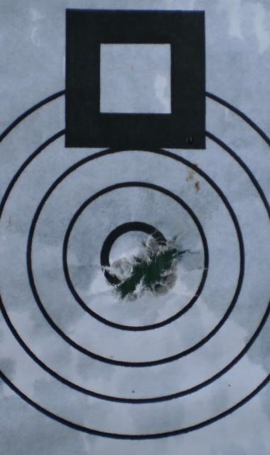

    I use 46.7 gr of IMR4064 with 168gr Nosler BTHPs with great results. .25 MOA at 100yds.
    3-shot
    7-shot
    Generally will hold 3-4" groups at 500 yards, usually with only about 1" vertical spread.
    I'm working up a load with 180gr SMKs, right now 47.8gr IMR4064 is giving me about .3-.4 MOA. Once I finish all of my ladders I will take it out to 500 and 1000.
