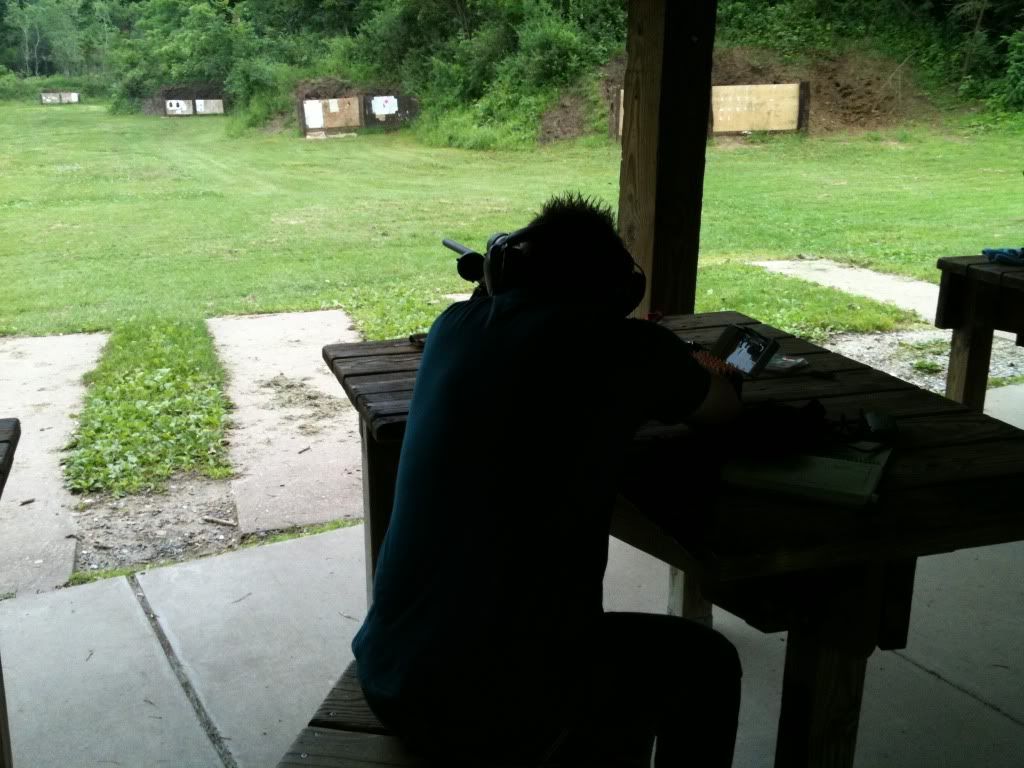

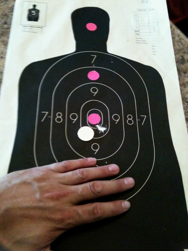

    That is a great starting place. i have winchester and federal brass, and i trim to 2.008. im using varget, and seating to standard COAL. my practice load is a little light, at 40 grains. i get 2260fps out of a 26" barrel. my competition load is a little bit light too, 42.5 grains and i get 2605 - 2627fps out of same barrel. both loads shoot lights out for me. i am including a picture of the target i shot this past saturday. shot from the benchrest @ 100 yards.
    The coin in the picture is a quarter. center to center the two outside shots measure 3/8". wish i hadnt thrown my 5th shot. thats the one on the farthest left.
