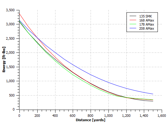

    Now, is there a lot of off-the-shelf match-grade ammo for you to shoot with a 270? Not really. Are there plenty of perfectly accurate bullets with decent BC's to pick from? Absolutely. So long as you handload, you can make this round do some amazing things, even out at long range. Perhaps most impressive is that it retains energy and bucks the wind a bit better at long range than its .30 caliber cousin (using the more common bullets). The recoil is noticeably milder on the 270 as well. Personally, my best results have been with the Sierra 135 grain Matchking BTHP, BC = 0.488. Out of my 26" barrel, I'm pushing these up between 3100 and 3200 fps at the muzzle, and I'm not seeing much in the way of pressure signs. Here's a comparison:
    Energy:
    By about 500 yards, the 135 grain SMK is pretty much indistinguishable from 168's and 178's out of a similarly barreled (and hot loaded) '06. The 208 AMax, of course, kicks the crap out of all of them.

    Obviously, these are far from perfect comparisons, but the ballpark shows that the performance is on par with or better than a good number of equally hot .30-06 loads. If you're handloading, you'd be surprised the accuracy and flatness you'll get in .270 Win. Plus, if you buy a Savage, you can turn it into an '06 later if you like. I got both :mrgreen:
