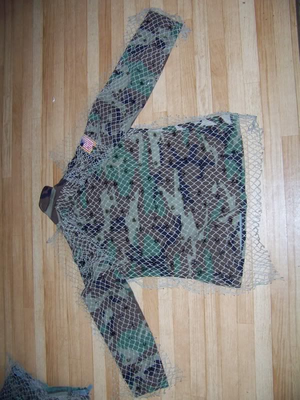

    Here are pictures of my shirt and pants with netting. The glue is drying now. Does this look alright? Anything you would recommend changing?
    The shirt looks kind of funny because of the way I had to fold the sleeves up to put the netting on the top, but you should get the idea. And obviously I need to do something about the nice bright American flag. :lol: I don't have a hat done yet because I ran out of netting, but I'll get that soon.
    And as for the upcoming part, the burlap. I got some of the strips that are specifically for making ghillie suits, a roll about 2.5" thick. The holes on the netting are pretty small, but I'm going to try tying strips then fraying them out. If that doesn't work I will have to fray and then tie. Where do I need to concentrate the most burlap to? I know this question gets asked a lot, but I just can't figure out how dense I need to make it to work well but still be light. Daddy, do you mind showing me some pics of how much burlap you have on your suit when you show me pictures of the cord?
    And one more question. I have the netting on their with the shoe goo stuff, it seems very strong, but is it enough, or should I sew it on as well?

    doing the sleeve wont really matter. might catch on stuff as you crawl but like i said I would go 1/3 most of the fun of making a ghillie is what you decide to do to it.
    the only thing i see that i wouldn't have done is you took the netting to the bottom of the pants. the problem there is if you tie on the burlap at the ankle your going to be tripping on the burlap as you walk so i would tie it on about 5 inches above the ankle (depending on length of your burlap)
    if i were you i would make sure i tie plenty of burlap around the sides of the ghillie. being that the point of the burlap is to break up your outline and to help you blend in somewhat.
    and yes for me the shoo goo is very strong i didn't need to sew but some people choose to.
