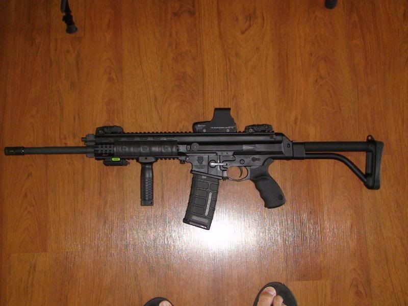

    My Robinson XCR review/range report
    http://i115.photobucket.com/albums/n295 ... C00371.jpg
    It's a Robinson Armament XCR (Light) in 5.56 with bull barrel and "enhanced" trigger. Features the standard stock (although I've ordered an adapter for an M4 folding version 2 weeks ago and still haven't receive it)
    As you can see it has an EOTECH and Magpul MBUS as well as a Lasermax green "uni" on the front. Also features an ergo grip (with plug...haha) and ergo hand guards. I'm not sure who made the pistol grip, I bought it from Wilson Combat.
    Okay, so I shot a combination of 55 grain Winchester and 62 grain Wolf. The gas setting was at "4" which is the highest setting and recommended for break-in.
    The rifle had 2 total malfunctions through 80 rounds. Both were the bolt group not going foward all the way, but pushing the round into the chamber. The second time it happened, I attemped to use the "forward assist" which on an XCR is simply nudging the side charging handle. No dice. I had to drop the mag, lock the bolt to the rear and fish the round out.
    I'll give the rifle the benefit of the doubt for the first 200 rounds or so.
    As far as accuracy goes, I couldn't report. I basically shot seated unsupported with my Eotech. I can tell you that my three round groups at 25 meters were as tight as any I've shot with an M-4. I buried 20 rounds at the end into the shoot-n-see using moderate rate of fire and had a total pattern about 5" in diameter. Not bad at all.
    As far as ergonomics go. Some highs and lows.
    Good: Shot 80 rounds through it and it literally took me 1/4 of the time to clean it(compared to an AR). The gas tube comes out so there's no ports or crazy spaces to worry about. The bolt is insanely simple....and it stays pretty darn clean, even with wolf ammo. As you would expect, the dirtiest parts are the gas tube and gas tube chamber.
    Good: Folding. Because the gas piston setup does't require a buffer tube in the stock, you can fold it. I bought a nice soft bag for it and it's just a little bit bigger than a standard suitcase (when arranged from corner to corner).
    Good: comes standard with little features like quad rails, single top rail and magpul enhanced trigger guard.
    Neutral: Magazine release. The magazine release is an ambidextrious button situated at the front bottom part of the trigger gaurd. You simply press down on it (from either side) and the mag drops. Being ambi, isn't really an advantage to me (I usually only shoot righty, but I guess, if I HAD to shoot lefty for some strange reason, it would be useful....but if that were the case.....dropping the mag would be the least of my worries)
    Good/Bad: Safety. The safety is ambi as well, and it features a 30 degree can't verses the 90 on an typical AR. Presumably, this makes it more ergonomic and quicker. HOWEVER, the safety on mine is VERY stiff and actually quite difficult to switch. If you do drills like most people which involve patrolling on safe, a fluid switch and fire, this safety MIGHT be considered a detriment. Hopefully it'll loosen up a litte.
    Bad: Weight distribution. As you'd expect, the rifle is a bit heavier and in the wrong place. The weight is more forward, which makes using a pistol grip close to the mag well almost a must. It's certainly not as nimble as a short M-4 and you can actually "feel" and notice the weight difference.
    Neutral: Charging handle. Features a side charging handle which allows you to charge the weapon while still trained on target/eyes down the sights. However, I can't think of a single situation where I was trying to charge my rifle while preoccupied with my target. If it's a jam, chances are you're going to have to turn the rifle and observe the chamber anyway. If you're loading a magazine, chances are the bolt is locked back (from the previous mag depletion) or you're loading it for the first time, so I don't think you'd go charging into a room without a mag in the well.
    Overall the rifle is high quality and tight. It has that feel to it that it was machined and assembled well and by those who knew what they were doing and generally cared about details. It "seemed" to be accurate and the felt recoil was negligible (didn't notice a discernable difference between the XCR and a typica AR setup).
    All in all, I'm happy, but have raised an eyebrow. My AR-4 malfunctioned only in one setting and the gas block had come loose. Otherwise it shot/fed like a dream. It was a pain to clean, but worked.
    I'm thinking that in extreme conditions (ie mud/dust/harsh duty like 10000 rounds through it) is where this rifle will shine. Obviously, most of us don't operate that way, but being a Glock fan, I like to know that when I squeeze, the firearm goes "bang." So I'll monitor and I can tell you this. I don't keep guns in my safe that aren't reliable. I've dumped Kimbers, Springfields, etc....that just weren't worth having around. 1 malfunction in 10000 rounds is one too many.
    More to follow
