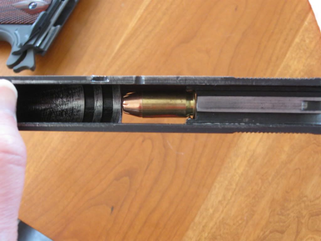

    Take a gander at the slide. Notice that we're testing the extractor tension. Slide a round under the extractor and slowly turn the slide upside down. The round should stay in place until you turn the slide around. And then it should barely fall free. So after 5000 rounds this extractor passes the test. It still maintains proper tension.

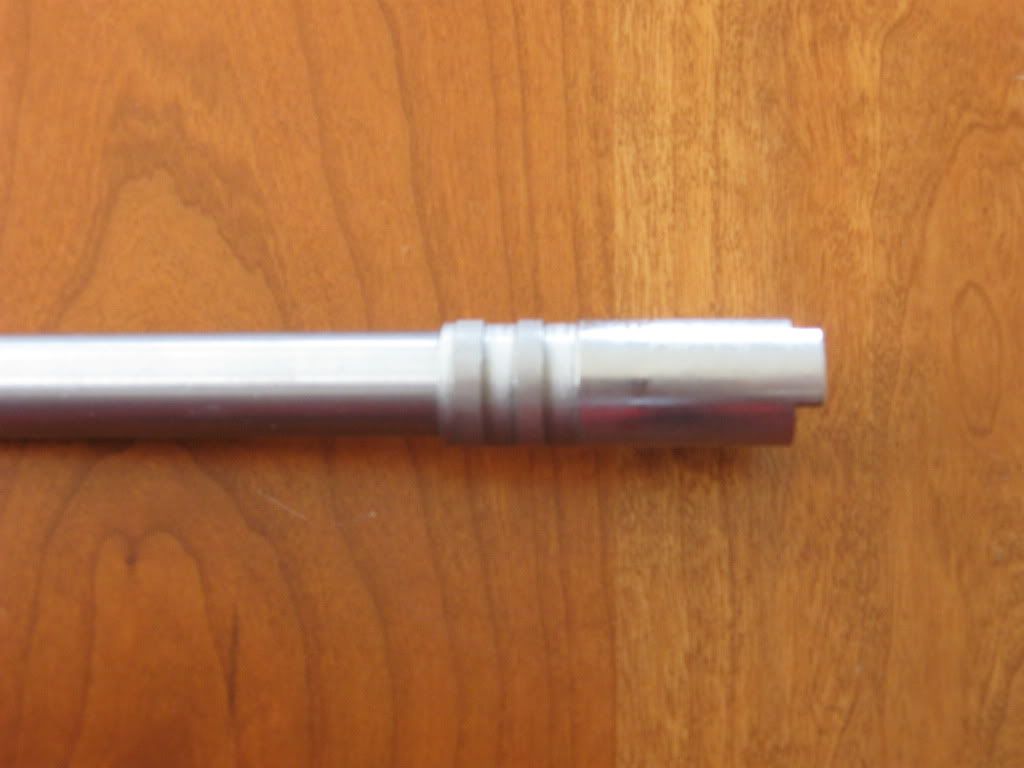

    And while we are at it, take a look at the locking lugs on the slide. There's no evidence of battering or peening, so you can tell that the barrel was probably fitted properly.
    Also if you look at the barrel lugs there's no evidence of any peening or battering. This is a very good sign when you take a look at a used pistol.

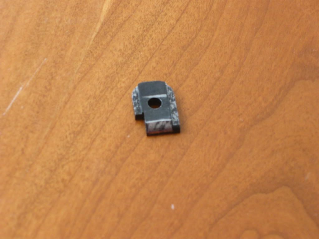

    Now take a look at the firing pin stop. While today Colt uses a cheap schmoed out stamped part, the Norinco firing pin stop is a solid piece of gutsy steel stock.

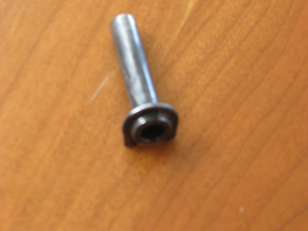

    The recoil spring guide is also a properly made piece of steel. Not a plastic part. And notice that the gun does not use a full length guide rod. Everything is as Browning intended.

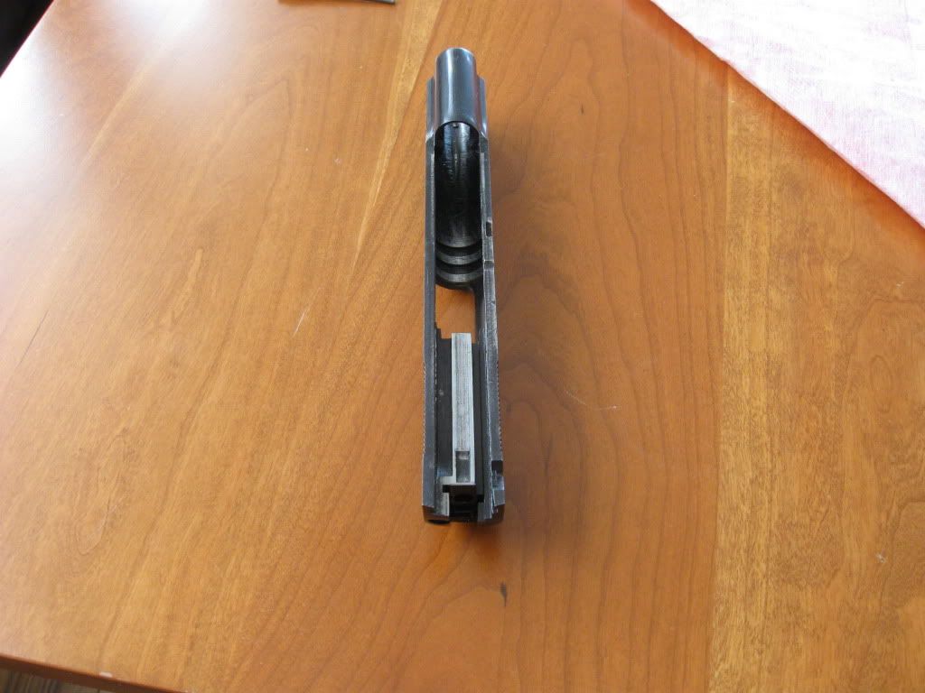

    Now take a look at the slide. Notice that it does not have a firing pin block or any such newfangled foolishness. The slide is made the way that Browning intended.

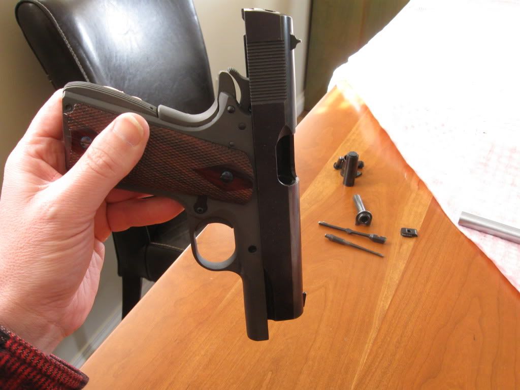

    Now take a look at the way the slide and frame fit together. We placed the slide on the frame without assembling any other parts. The slide does not fall free. It sits on the frame firmly. And when the pistol is assembled, everything fits tightly. Not too tight, but just right. This is not one of those 1911s that rattles.

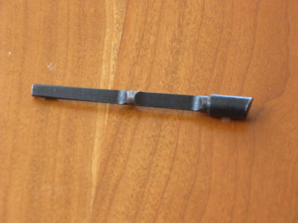

    I forgot to post pictures of the recoil spring guilde. Here it is. As you can see, it is slightly out of focus. But I'm dealing with a myopic, squinty eyed schnook of a camera man.

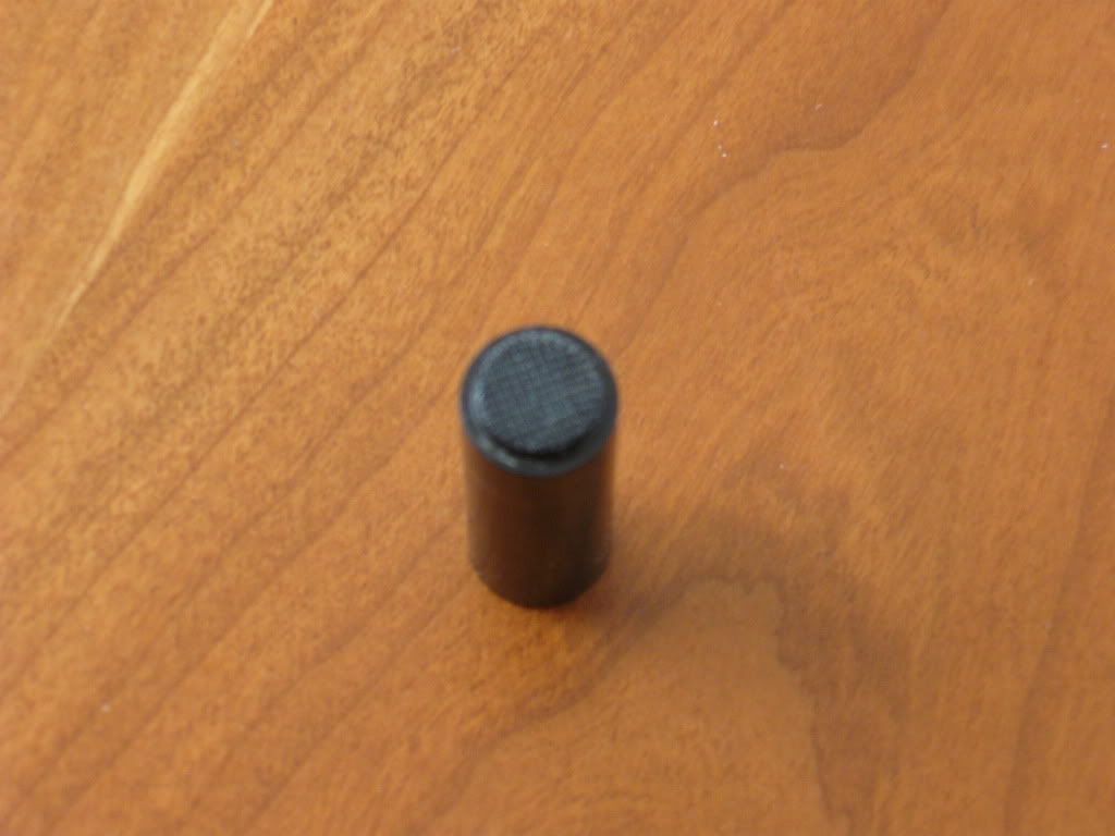

    And here's the recoil spring plug. It is also solid steel.
