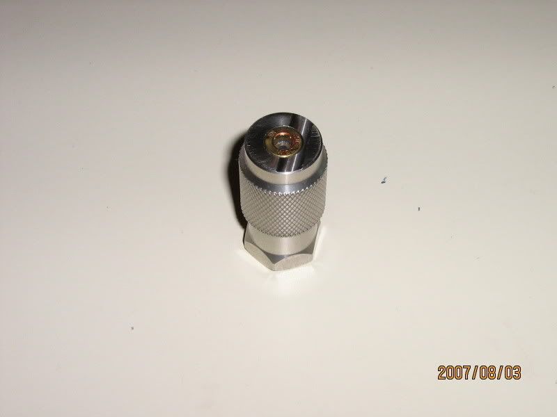

    Now let's discuss the pictures. In the last picture, you can see the Dillon Cartridge case headspace guage. You can see that it resembles the chamber of a gun. You can also see in the picture that one end of the chamber is stepped. The case chambered within the guage must sit slightly higher than the stepped portion of the guage. The case must also sit flush with the non-stepped part of the guage. You simply run your finger over the stepped portion of the guage and you should be able to feel the case head sitting ever so slightly above the surface of the guage.
    The other headspace guage picture shows a case inside the Dillon tool. This view is from the top of the guage. And as you can see, the case does not protrude from the guage. Thus we can tell that this case does not need to be trimmed.

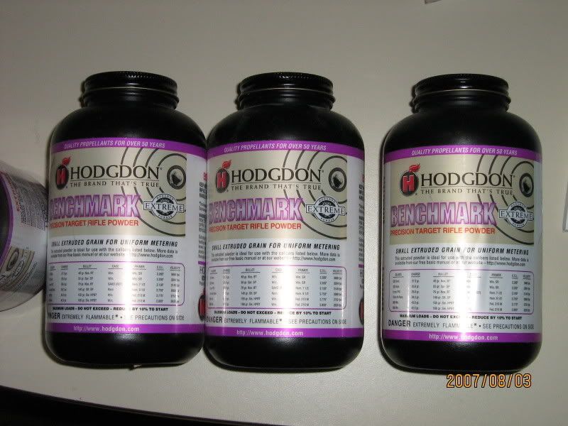

    I just sent Jeff two more pictures. The first picture shows some of the Benchmark that I used.
    The second picture shows the Dillon headspace guage in use. Notice how the cartridge case fits neatly into the die. The case fits slightly above the stepped surface of the guage. The case also fits flush with the non stepped area of the guage.

    The other day I had an idea. I decided to use my RCBS precision mic to measure my sized cases. Recall that I sized the cases to exactly fit inside my Dillon headspace guage.
    Cases sized to fit inside the Dillon headspace guage measured "zero" inside the RCBS precision mic.
    This tells me that if you size your brass to fit inside the Dillon guage, your cases will be sized for absolutely minimum headspace. ( "Headspace Zero") Cases so sized will fit into any .223 chamber.
    I measured fired cases from one of my rifles and they measure +3. This means that the headspace of this rifle is three thousanths over the minimum. Ammo sized in my die will expand by three thousanths in this rifle.
    The RCBS precision mic told me several things:
    1. The rifle has safe headspace;
    2. The Dillon headspace guage works exactly as advertized. If a round will fit inside the Dillon guage it will fit in any .223 chamber.
    3. Brass expands by .003" inside my rifle.
    Now for loading .308 ball ammo, I recommend that the Dillon headspace guage be used in order that the sized cases are all at headspace zero.
