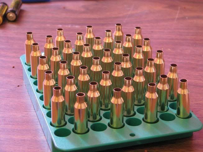

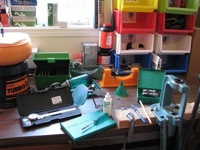

    Well here we go. I'm loading for .22-250 Remington, and we've got 78 cases to load up.
    This is not an instructional guide; I'm trying only to take pictures of the steps and to give a general idea of how reloading goes for those who maybe aren't sure. And, by the by, I'm a newbie at this myself. If you have any tips for me, let me know .

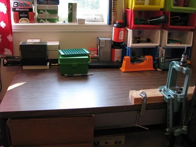

    This is all the stuff laid out.
    This is everything put away with a nice and tidy workspace.

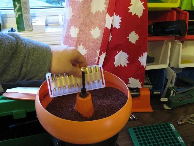

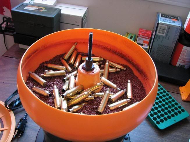

    Dump the brass in the tumbler and plug 'er in.
    Shake out the media. (Federal's plastic thingies are nice)

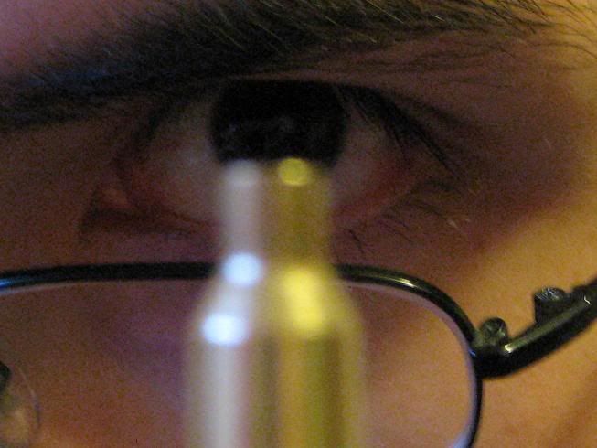

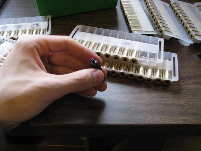

    Inspect each case carefully for faults...
    These ones seem alright.

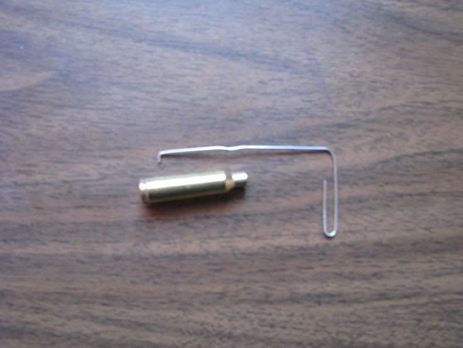

    You can use a paperclip like this to test for imminent case head separations.

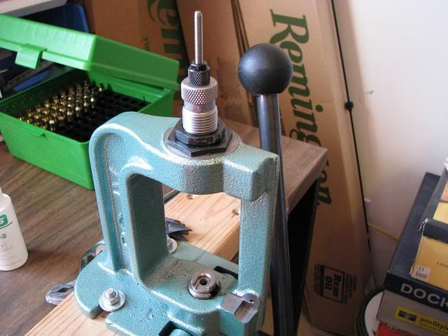

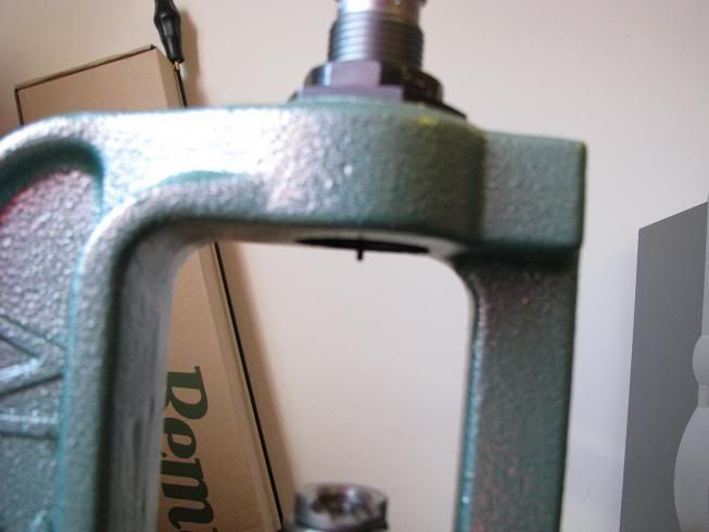

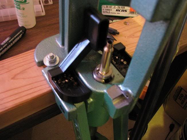

    Set your sizing/decapping die... (you can also see the shell holder there)
    (There's the decapping pin)
    ...Lube 'em up... (excuse the tumbler media dust)

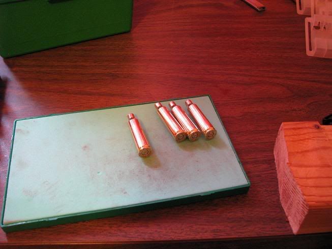

    ...And run them through the die.
    Presto, some expended primers and a sized case.

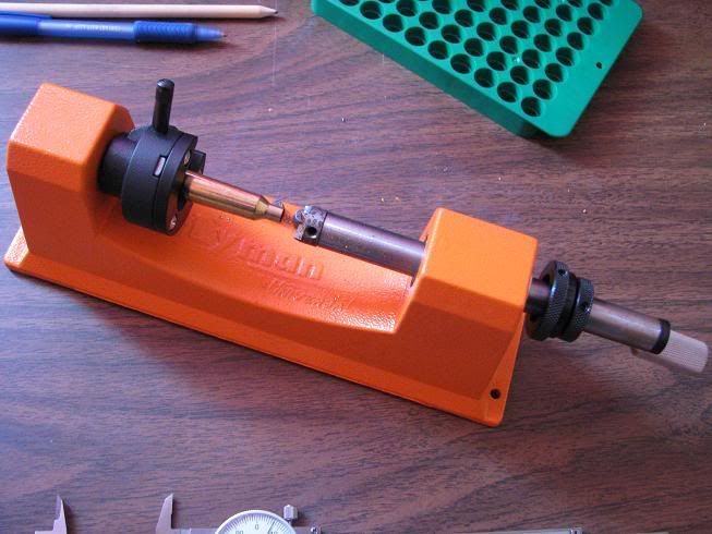

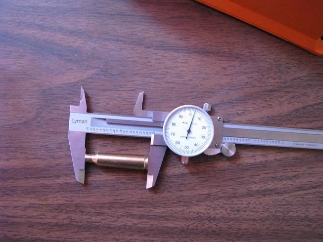

    Looks like we don't need to trim this time...
    But it's as simple as sticking the case in here and turning the crank.

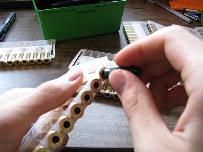

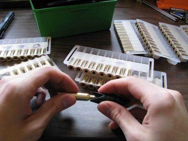

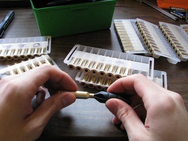

    If you've trimmed, chamfer...
    ...And deburr.

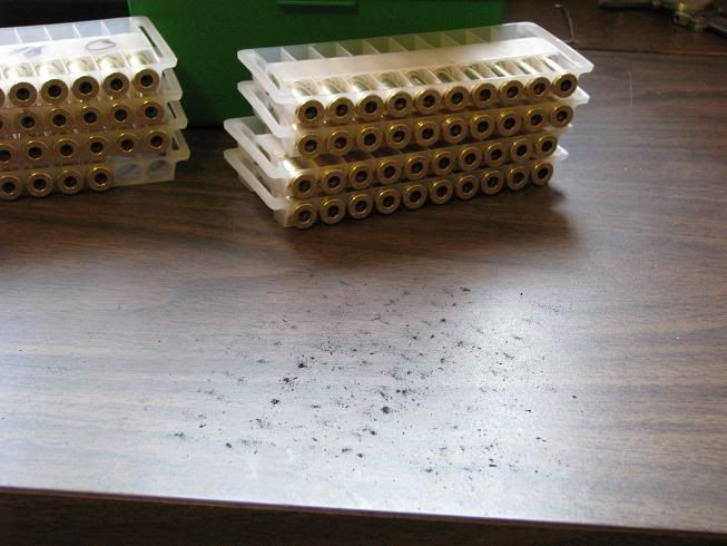

    Lee Primer Pocket Cleaning Tool
    Primer pocket cleaning. (Federal's plastic thingies again)
    All the primer ash.

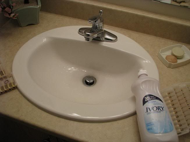

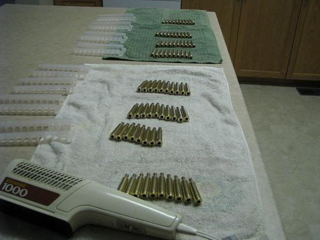

    I wet clean them at this point to remove the lube, though I know lots of folks just toss them back in the tumbler for a spell. (Once more, my love for the plastic thingies is demonstrated)
    Dried with hairdrier and towel. The woman of your house may prefer use of rags. You could also do the dishes at the same time as your brass for some brownie points...
    And we're ready to load! Make sure the inside is totally dry before moving on. That's all I can fit for today, my light (the sun) is going down. Upcoming is priming, charging, bullet seating, and whatever else.

    Yeah, the only reason I wet clean is the tumbler leaves a lot of media dust inside the cases which I'd rather not have there. I do hate the washing & drying process, it takes much longer than I'd like, but I don't know what else to do. I haven't tried corncob media yet, though. Does it leave less dust/residue than the walnut? Or, I still haven't gotten my hands on dryer sheets... do they work for this? Or am I just being too anal about the entire matter?

    Washing the brass in some way after tumbling, etc makes sense as it would also clear out any of the gunk that might have accumulated on the resizing pin that can be transferred from case to case etc. The very nature of using a media to clean cases will undoubtedly lead to tiny bits & pieces of stuff being left in the case which *could* interfere with the ignition process.
    I 'wash' my 223 brass in general purpose thinners after buffing (I buff each case one by one on a buffing wheel as it has been the only way to get cases back to the very nice & shiny bright colour as like new brass) neck sizing and decapping. I've been using the same cases for about the last 4 - 5 years without problems and I only FL resize when the cases get sticky, etc.
