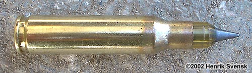

It is a SABOT round. It is a heavily modified Winchester SLAP. Slightly lower velocity, but heavier projectile. It is the issued sniper ammo for Swedish snipers, and effective range for our PSG90's has been extended out to around 1200m at most. And it cuts through vests better than many heavier rounds. But we're digressing from the topic of this thread =)

Mel:
Yes, the current breed is indeed better.
Lower velocity, around 1260m/s but heavier(6.2g), with the same diameter, so retardation is even lower. Lots of kinetic energy too.
Most of the 1 million rounds ordered from Winchester in 1998 are placed in various weapon caches and mobilization storage.
V0 and Energy are at muzzle, any other distances would depend on external factors too.
Diameter of projectile is 4.81mm
Area of cross-section: Roughly 18.17 mm²
Original Winchester SLAP:
V0=1340m/s
Mass=3.4g
Energy=3052.52 joule
Energy/mm²=168 joule rounded up
7.62x51 Sk PTR10 Prick(T)
V0=1260m/s
Mass=6.2g
Energy=4921,56 joule
Energy/mm²=271 joule rounded up
As a contrast, here's the stats for the 7.62x51 SK Ptr10 PPrj (Swedish AP ammo)
Area of cross-section: 45.6mm²
V0=960m/s
Mass=8.2g
Energy=3778.56 joule
Energy/mm²=82.9 joule
