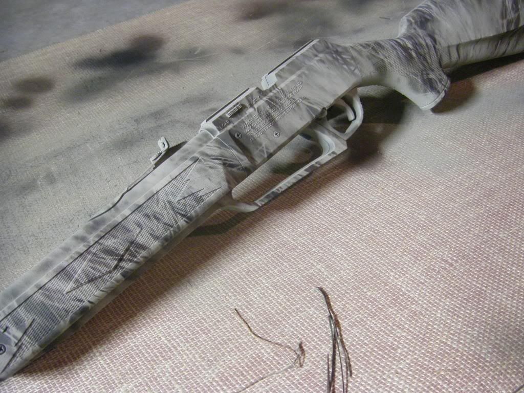

First, this is not my idea, but what I want to do to my rifle and wanted to share it with others.
you use pine straw or broom straw to camo your rifle. here are some pics I borrowed from another place on the web.
MORE INFO
A few ideas,
Holding the straw closer or right on the gun gives a cleaner "line"
if you hold the straw farther away it is more blurry.
I think it looks better if the lines are diagonal to the gun, not straight up and down.
use cardboard cut outs of your gun to practice with. experiment with different techniques. (record each step) or video so it is repeatable.
use a combination of pine straw and broom bristles to get different size lines. practice practice practice before painting to get a great como job you like.
I think more than 3 colors makes it look to busy (messy) the pics i posted are the ones I liked best, there were probably 50 others I did not like.
and here is a quick how to,
1st paint the base color
then add your pine needles and paint second color
then it looks like this
then add needles again and another color
then you get this, not bad at all and really simple.
several more fine examples using pine straw
and here are some awesome camo jobs that are just cool
COOL SKULLS if you look close, I went online and found the skull templates to do this with, and will be using it on my AR57, and doing a regular pine needle job on the sniper rifle I think.
the webbing can be done using the mesh laundry bags from wal-mart or fishnet stockings or the stuff you put over rain gutters to keep leaves out or other items,

as I mentioned in the write up, I did not do any of these, I stole it from another gun forum, although I've done stuff similar, my thoughts are it depends what kind of paint job you want,
if you secure it right against it. the outer lines of the webbing will be more defined, if you leave it loose it will be more of a faded transition. (blurry effect)
judging buy the pics I posted I would say the webbing was tight against the gun for a cleaner line.

I just wanted to post because I used this process to paint my 17hmr and I think it really turned out nice. It was very easy to do I might add. I posted the pictures of it in the Gallery for all to see.
