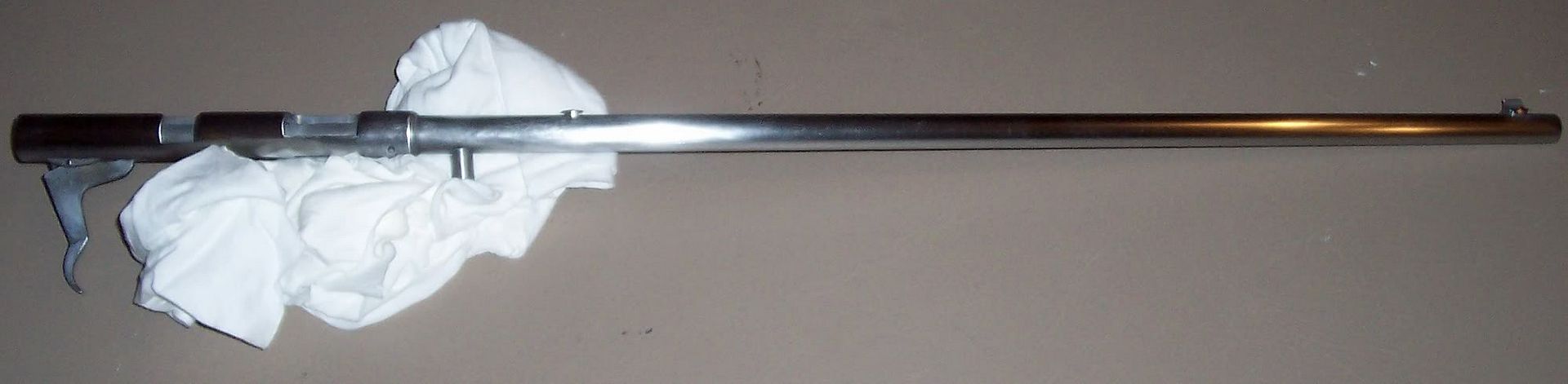

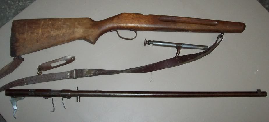

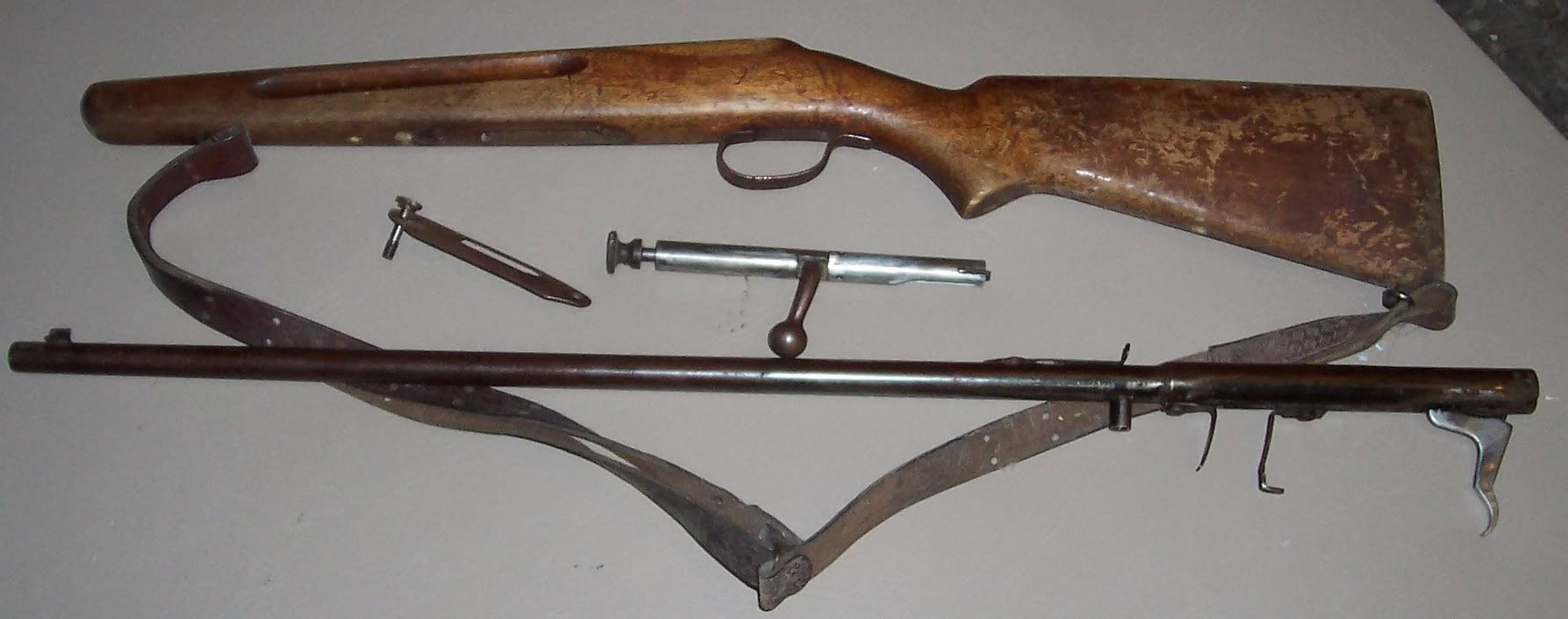

Hey all, with the cheap bolt action 22 thread, I decided to post this project an keep you posted as I progress. The initial cost of the rifle was $5 at a garage sale. It is a Springfield M56 22 S, L, LR. The rifle was very rusty on the outside, but the bore was good, and it did fire, although it was missing a magazine.
As you can see it was a mess. I found a 10rd Mag at Numrich for $17, and so far I have about 6hrs(all last night), and about$5 in polishing materials, and Chemicals in it. All polishing is being done by hand, lots o work, but good for me right? THe stock will be stripped today, and the rest of the polishing done. I hope to get it blued this week as well. I can use cold blue to show what can be done on low cost, or I can hot blue it I have not decided. Or I could park it, but I like blue on this rifle better. What would you like to see? The cold blue I use is Oxpho Blue gel from Brownells.

I do parking at home now, have buig vibratory polishing set up that can do everthing but barrels. It works better than blasting as it is set and forget, works while I sleep. The hardware on my garands was done by me excpet the match one. I have now finished the polishing, and yes I have used the dremel, and now have a huge hand polisher cutter from Sears. It is like a dremel on roids. I still like working by hand though. I am going to cold blue this one. I have used Oxpho blue before on shotguns, and it is as hard as any hot blue I have, and looks very nice. I will post later with all the details. Back to working on the stock, later guys.

Ok guys, I have gotten quite a bit of work done today(wife is kind o mad though so I let her go out for while and took the kis off her hands). This rifle is being done to be a beat around truck rifle/kids first rifle for my oldest friend and hunting buddy.
You saw how it looke when he found it at the garage sale, so cut me some slack, I am not a miracle worker. The stock has major issues, mainly it is one ugly piece of wood, some cracks and lots of dings. The cracks I fixed, the dings I fixed some of, sanded others, and just plain gave up on some. There is a stain on the but, that just will not come out, I stripped it times, bleached it, and sanded it, but it is still there. I sanded this stock(I hate to use sandpaper on stocks, I usually only use steel wool) with 80, 120, 320, and finally 0000 Steel Wool.

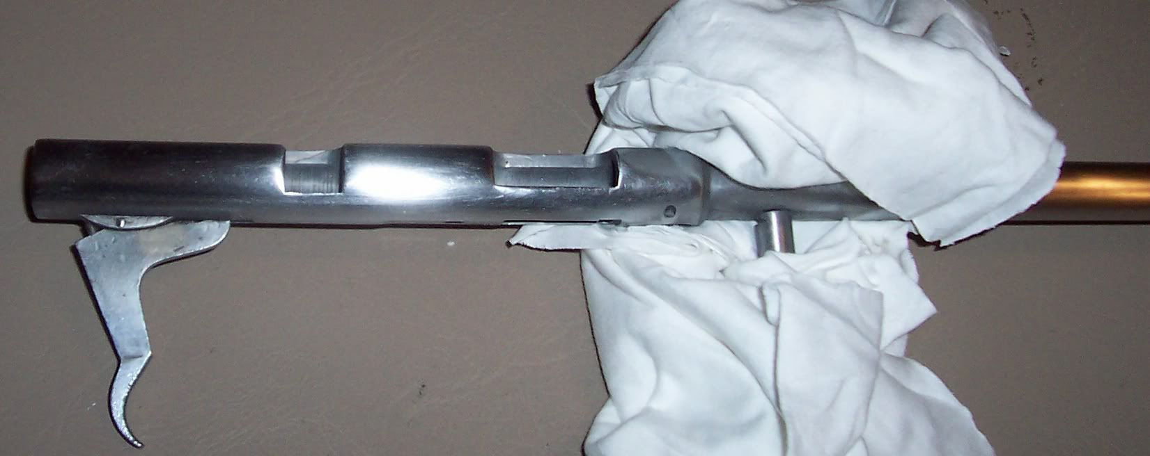

The rifle was very heavily pitted in areas, but I did polish most of it out, although some were so deep I would have had to really thin out the contour of the barrel to get them all the way out. I have about 9-10hrs of polish time in on this one, and that does not include the chemical rust/blue removal time. The Polishing consisted of coarse emryclth followed by medium, then fine switching directions on each one. I then hit it with 400grit paper, and finally both directions two times with 600 grit.
The cold blue I used is Oxpho Blue Creme from Brownells. To prep the rifle I degreased 2 times with Acetone, and then never touched with bare hands after that. I used a method that I read in some information from Brownells that came with the Oxpho Blue. I used a pad of 0000 Steel Wool, and applied the Oxpho Blue to the pad, and buffed the rifle with the steel wool. The rifle soon had a nice deep black color. I applied the creme 3 times, and the entire rifle took the color well. Using an abrasive application method helps to make a more abrasion resistant finish. Ihave used this finish before, and have had good luck, plus it touches up easy if it does get dinged or scratched.
I have some pics below of the rifle as it currently looks. The one with two barrels in it is the 22 next to a nearly perfect M700 Rem barrel in factory High polish blue. The stock is not done, and only has one coat of stain. I currently plan to hit the stock with 0000 Steel Wool, and two coats of stain, and 3 coats of Tung Oil. It may not end up pretty, but it will be protected.

OK the metal is out of the Polisher, and looks real good. I will get the finish on tomarrow. This thing is coming along nicely, the only hard part left is sahping the butt and Plate to match up. I found that a Marlin sight elevator should work, so that problem is fixed, and I will order the mag from Numrich this week. I may do one or two more darkening coats on on the barrel/receiver combo, and I am going to see about jeweling the bolt just for kicks.
