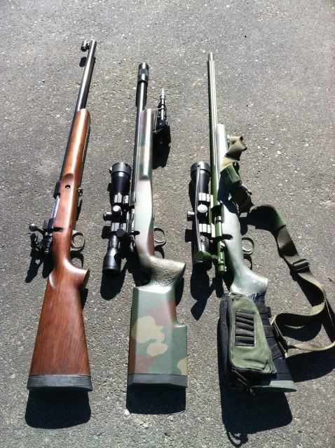

Here is my 1200tx.
I was wondering if you gentleman know what scope bases I can get that will fit her?
regards
-s
See less See more
I think that Farrel (Farrell sp?) may make a base for it if a standard Mauser 98 base won't work.
Standard mauser I have Leopold quick detach mounts on mine.
