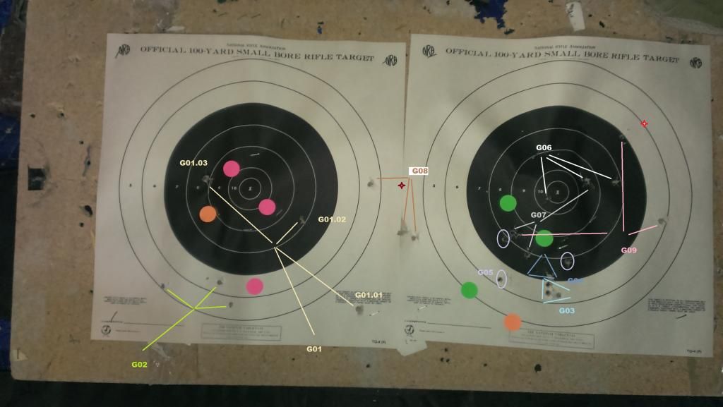

Equipment: 5.56 upper with eotech, ir laser, bump helmet, pinnacle and L3 pvs-14s. Federal Lake City 62gr grn tip.
Activity: Moving everything over to 5.56 rifle as a roll pen fell out of the .22LR and it will not go back in tightly. This disabled the bolt carrier latch on the upper and thus disables the upper. I called PA. They are sending me a new bolt carrier group to improve the performance of the system with a timney trigger, which they got and have been testing. They will also send me some roll pins. Besides making a perfect gun, your only other option, is to try to help your customers address issues, and these guys seem to be doing it.
Note in the pic, the bipod is shown to keep the rifle upright. The eotech 3x magnifier is not shown. The PVS-14 3x magnifier, shown, is not used in immediately subsequent exercises. The attachments shown would not all be used together, but needed to be fitting to make room for all plausible attachments for current goals.
So Eotech, laser, 14 base, now on 5.56 upper. Starting over!
First zeroing on left target at twilight with eotech and no magnifier at 25yds, standing un supported. No night vision for these shots. Target was very dark and hard to see. But I could barely see it so I went ahead.
Group01, Shot01 (G01.01) Low right, cranked 4 up and 4 left on the eotech
G01.02 Shift up and left but not enough. Cranked 2 left and 1 up.
G01.03 Hit left. G01 Score 16
G02 Then put 14 on the rifle with nv reticle and no magnification. Group 2 is low. Hum. Does this mean I need to adjust when adding the PVS-14? I guess I've always used the magnifier on the 14 before and I didn't have to adjust. G02 score 16
All remaining groups used PVS-14s, no magifier, 25yds standing unsupported.
G03 - decent group but low, cranked up 4 clicks Score 18
G04 - decent group still low, cranked up 6 clicks Score 21
G05 - took too much time aiming, group still low, cranked up 8 clicks. I was begining to wonder what was happening to my clicks. Score 17
G06 - Ok, this group was on target. Score 27
G07 - First group using laser and PVS-14 on rifle, NV reticle turned off. Reasonable regarding average elevation and windage, but bloom on the laser obscures target. Have to move laser onto target and guess when there. Score 24
G08 - Too many holes in the center of the target, to tried to aim exactly between the two targets. score NA
G09 - Tried to aim high right. Score NA
What did I learn from this? Well, my reaction is why did it take so many clicks to get zeroed? I need to try to find out how the eotech clicks work. With regular scopes, things are very predictable. I'm not there yet with the eotech.
I may need to try a less flat, less reflective target surface with the ir laser. These flat, reflective surfaces generate too much bloom. Maybe I'll use some old rug pieces.
As to those two tight groups G03, G04, I was surprised, especially as they were back to back. I was firing quickly and just focusing on the reticle and trying to see the reticle with black around it (the black circle) and when I did I fired. It seems the faster I aim/fire, the tighter the group. This is a whole different way of thinking from what I've been trying to do a longer ranges ... aim constantly and squeeze slowly. This is aim quick/fire. I hope I don't forget all I've learned about long range shooting !!! Although, maybe that is nothing ! :)

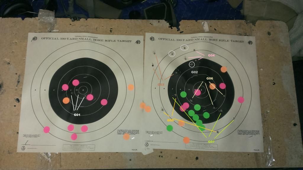

Equipment: 5.56 upper with eotech, 3x magnifier, 62gr.
Activity: Checking zero at 100yds, all shots standing unsupported.
Group 01 - Fired 3 rd group at 25yds. This is the left target. No magnifier. Score 29/30
Group 02 - Fired 3 rd group at 100yds with 3x magnifier. Was high and left. Score 17/30
Group 03 - Decided to try same over without the magnifier, this 3 rd group was high and left, same as with magnifier. That was what I wanted to see. So I cranked down 3 and right 3. I haven't been able to find anyone who will tell me what a click on an eotech is, so I'm just guessing. Score 7/30
Group 04 - This group was a little less high and more centered. No magnifier. Score 18/30
Group 05 - In cases like this FM 3-22.9 says to use "bold adjustments" so I went down 8 clicks. Got some wobble this time, but was low and a little left. No magnifier. Score 17/30.
Group 06 - Up 3 clicks and right 2 clicks. No magnifier. Score 25/30.
Group 07 - Added magnifier, more wobble. Score 18/30.
Avg Score at 100yds: 17
Avg Score at 100yds with magnifier: 17.5
Avg Score at 100yds without magnifier: 16.75
So, what did I learn from this?
101 - From 25 to 100yds, the 5.56 round is climbing. I'd say I already knew that, but I reconfirmed it today :).
102 - The magnifier does not seem to affect to POI. There are two ways it might (A) If it was adjusted wrong (B) If it caused me to "aim harder" and thus spread out my shots. The magnifier does help me see the target better, but dispite that, does not seem to actually help me hit better. I've trying to build up confidence to reduce use of magnifier, so this is helping.
Next time (night) I will try thermal and ir laser again at 100yds.

G01 (6 rounds) on tripod confirming zero of clipon. Score 49/6 (avg 8.16)
G02 (6 rounds) on tripod, using laser but also looking through scope so seeing reticle through clipon as well. The center of the reticle looking a little low and right when the laser was centered on the target. Score 43/6 (avg 7.16)
G03 (5 rounds) on tripod, laser only seen through pvs-14 on helmet, not using scope. Score 18/5 (avg 3.6)
Obviously we are low and right!
G04 (4 rounds, 1 jam) on tripod, laser only. Score 10/4 (avg 2.5) Low, but more centered.
G05 (4 rounds, 1 jam) on tripod, laser only. Score 29/4 (avg 7.25) less low, centered.
G06 (5 rounds) on tripod, laser only. Score 36/5 (avg 7.2) scattered around the center.
Summary: For me, when zeroing Laser Max IR-Laser, it is more efficient to use a scope and NV clipon, on the rifle. Trying to zero with just the laser results in 6 inches left, 6 inches right, 6 inches left back and forth behavior. Trying to use PVS-14 on helmet looking through the scope, didn't work as well either. So the technique used tonight seemed more efficient. Using the EoTech is fine, but right now, I don't want to move the EoTech off the 5.56 rifle. The EoTech and the ir-laser over there I want to keep there, at least until after hunting season.

Equipment: Confirming ir-laser zero in field, 25 yards, with 3.5-10x, PS-22 and tripod supporting.
Activity:
G01 - Fired 3 rds with scope/ps-22, score 23/3 (avg 7.66)
G02 - Fired 3 rds with ir-laser as seen through pvs-14 on helmet. Score 24/3 (avg 8)
G03 - Fired 6 rds with ir-laser as seen through pvs-14 on helmet. Score 44/6 (avg 7.33)
Summary: The bloom makes it difficult to see the target. I have no filter on the pvs-14 and no filter on the laser. Acquisition of those items is in the works. I do have a filter on the ir-laser on the 5.56 rifle.

2014-08-22
2100-2230
70F
10 mph S
Environment: No moon, lots of stars, 20% cloud cover. Andromeda visible. Wind moving the wind turbine well, but not felt as strongly on the ground. Some lightening to the SE and West. So good that it is getting dark sooner, now if it will just get a little cooler.
Equipment: Dual 14s on helmet, thermal and ir-laser on .22LR with sling. Also added Harris 6-9 bipod on front of rifle for extra weight up front.
Activity: Drove buggy around the main pasture, about 85 acres, the buggy trail was hard to see in places, but I was able to maintain 80-100% of daylight speed. Coyotes audible to the South and cows visible in South pasture. Set up targets and one hand warmer.
With the ir-laser:
G01 - 15yds, 2 rds. Score 19, avg 9.5
G02 - 25yds, 5 rds. Score 28, avg 5.6
G03 - 25yds, 5 rds. Score 33, avg 6.6
G04 - 37yds, 3 rds. Score 17, avg 5.6
G05 - 37yds, 2 rds. Score 15, avg 7.5
With the thermal:
G06 - 15yds, 2 rds. Score 19, avg 9.5
G07 - 25yds, 2 rds. Score 16, avg 8
G08 - 37yds, 1 rd. Score 9, avg 9
Summary: Apparently the standing unsupported, quick aim/fire technique requires sustained, regular practice as I think I am a bit rusty after almost 2 weeks of slacking off. Harvest time tends to mess with my shooting schedule and that will continue for another 2 weeks roughly.
With the laser at 37yds I was moving the laser onto the target from the left, instead of below. I still have lots of bloom this close up and it is tough to see the targets. I have to look at the other targets to try to judge where the laser is pointed.
I also need to tighten the sling, it was too loose and not helping much.
With the thermal I could see the rounds striking the target, but that doesn't help much as I'm trying to aim at the center of the hand warmer every time.
