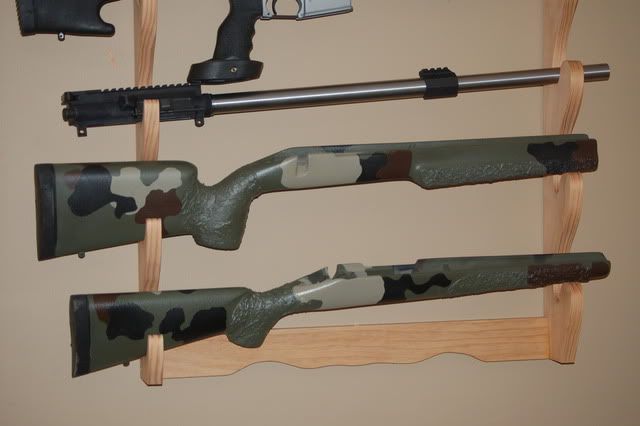

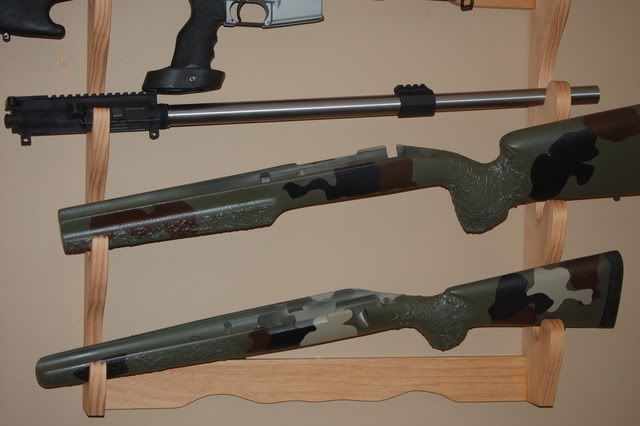

After reading over this topic a few times I finally decided to try this mod on my new Bell & Carlson stock. I used Gray Marine Tex and followed all of the directions listed here. I wanted a little more of a pattern to the gripping surface so I took a heavy duty plastic fork and raked a pattern into the grip and forearm area. I found that a vertical pattern worked better on the forearm while a wavy kinda horizontal pattern worked best on the grip area......it looks pretty cool also. Using the plastic fork did leave fairly sharp "peaks" that I sanded out till I had just the right amount of grip texture that I wanted. Pics to follow ......thanks for a great thread
